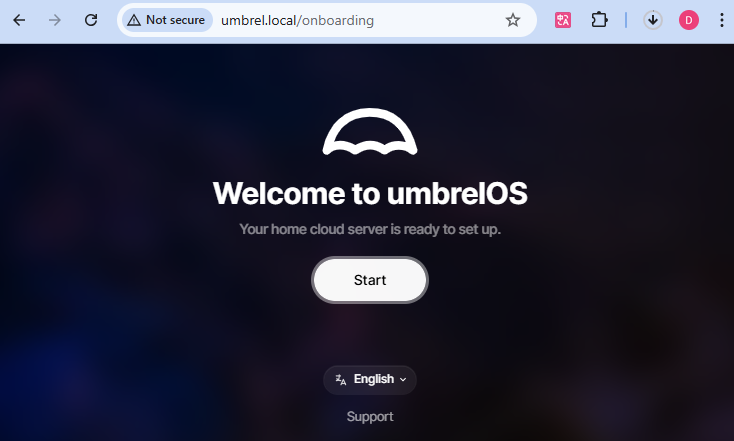

  2. Open your browser and visit: http://umbrel.local. If the page does not open, check your router for the Umbrel device’s IP address, for example: http://192.168.1.50
    ../../_images/umbrel_local.png

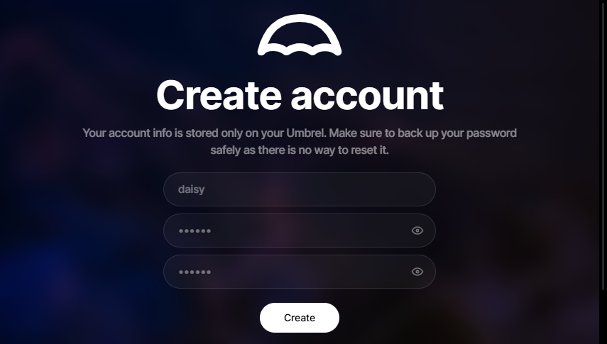

  3. Create your Umbrel account by setting a username and password. This password will be required for future remote access, so please keep it safe.
    ../../_images/umbrel_account.png

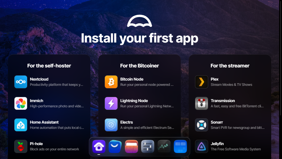

  4. Click Next to complete the Umbrel setup and enter the desktop environment.
    ../../_images/umbrel_desktop.png

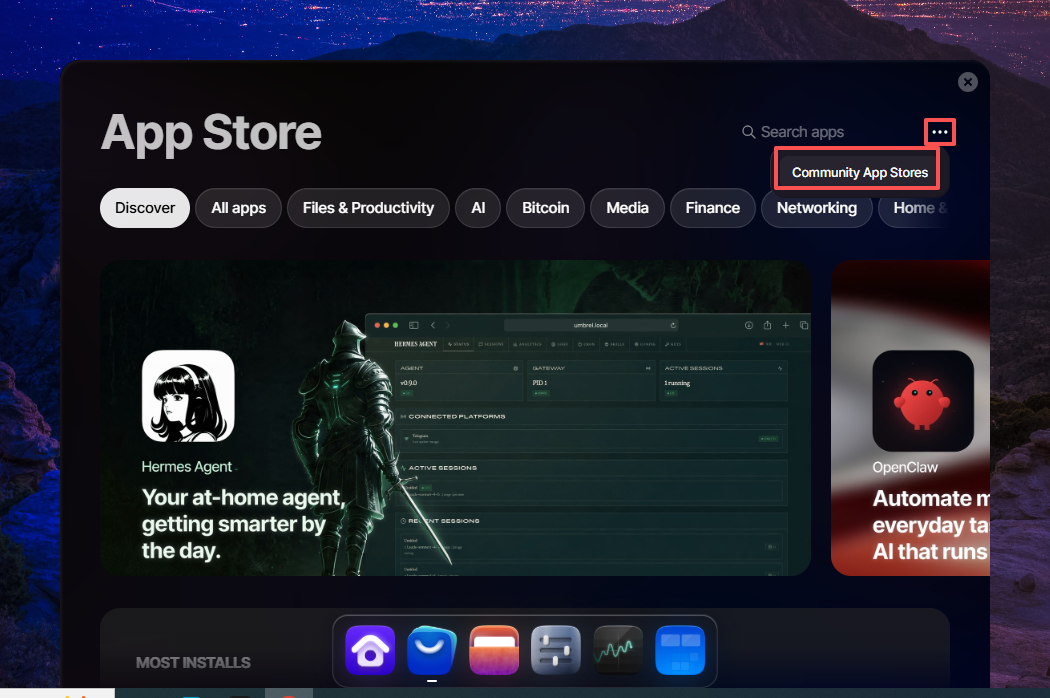

  5. Click the App Store icon to open it.
    ../../_images/umbrel_app_store.png
  6. In the Umbrel App Store, click the Community App Store button in the top-right corner.
    ../../_images/umbrel_community_app.png

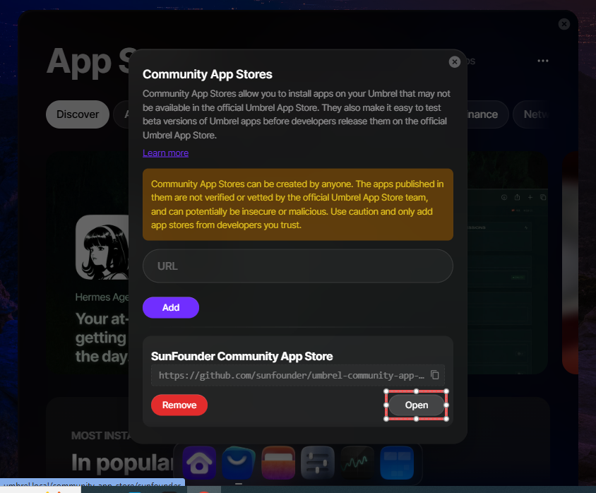

  8. After adding the repository, click Open to access the SunFounder Store.
    ../../_images/umbrel_open.png

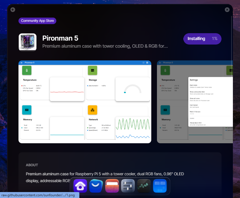

  10. Click Install to begin the installation.
    ../../_images/umbrel_app_install.png
