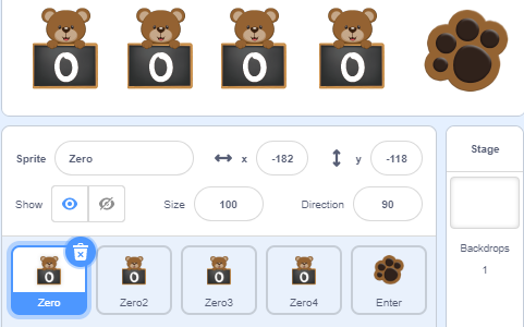

First, we delete the previous sprite. Upload the Zero.png file and Enter.png file in the sprite list, you have downloaded them from github - 7-diy-touch-screen before.
Then we upload the One.png file in the Costumes option of the Zero sprite, so that the Zero sprite has Zero costume and One costume.
Then we copy the Zero sprite with the right mouse button, and there will be 3 new Zero sprites in the stage area.
Set the default costume of the four sprites to Zero, record with the variables “num1”, “num2”, “num3”, and “num4” respectively, and initialize the positions of the four sprites.
The program in the figure below is the program of the Zero sprite. The other three Zero sprites modify the variable names and increase the X coordinate by 80 to make the effect arranged in order from left to right.
