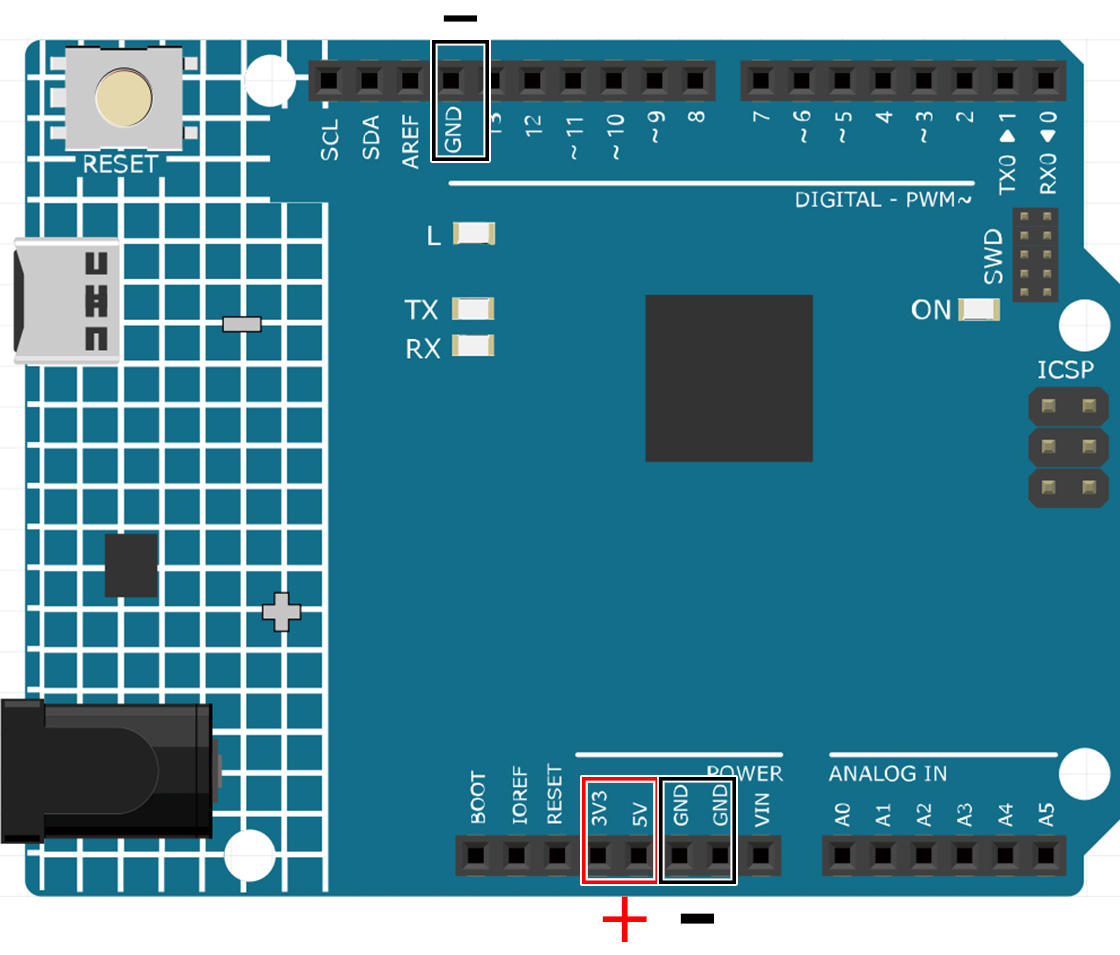

The Arduino Board has some power output pins (positive) and some ground pins (negative). You can use these pins as the positive and negative sides of the power supply by plugging the power source into the board.

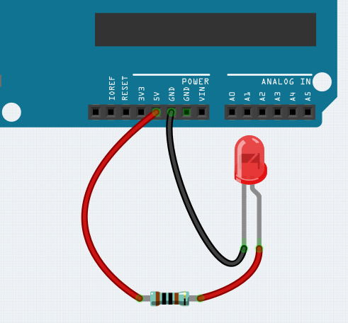

With electricity, you can create works with light, sound, and motion. You can light up an LED by connecting the long pin to the positive terminal and the short pin to the negative terminal. The LED will break down very quickly if you do this, so you need to add a 1k* resistor inside the circuit to protect it.
The circuit they form is shown below.

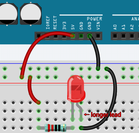

Let us follow the direction of the current to build the circuit!
../_images/connect_led.png
  1. In this circuit, we use the 5V pin of the board to power the LED. Use a male-to-male (M2M) jumper wire to connect it to the red power bus.
  2. To protect the LED, the current must pass through a 1k ohm resistor. Connect one end (either end) of the resistor to the red power bus, and the other end to the free row of the breadboard.
    The color ring of the 1k ohm resistor is brown, black, black, brown and brown.
  3. If you pick up the LED, you will see that one of its leads is longer than the other. Connect the longer lead to the same row as the resistor, and the shorter lead to the other row.
    The longer lead is the anode, which represents the positive side of the circuit; the shorter lead is the cathode, which represents the negative side.
    The anode needs to be connected to the GPIO pin through a resistor; the cathode needs to be connected to the GND pin.
  4. Using a male-to-male (M2M) jumper wire, connect the LED short pin to the breadboard’s negative power bus.
  5. Connect the GND pin of board to the negative power bus using a jumper.

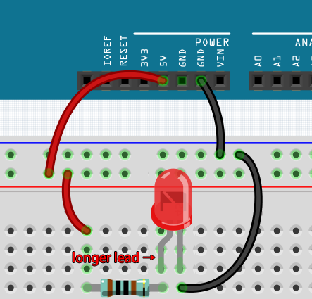

Direction of the circuit¶
There is an orientation to circuits, and the orientation plays a significant role in certain electronic components. There are some devices with polarity, which means they must be connected correctly based on their positive and negative poles. Circuits built with the wrong orientation will not function properly.
../_images/connect_led_reverse.png
If you reverse the LED in this simple circuit that we built earlier, you will find that it no longer works.
In contrast, some devices have no direction, such as the resistors in this circuit, so you can try inverting them without affecting the LEDs’ normal operation.
Most components and modules with labels such as “+”, “-”, “GND”, “VCC” or have pins of different lengths must be connected to the circuit in a specific way.

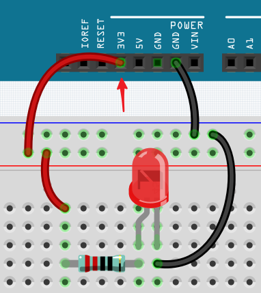

About Ohm’s law we can do a simple experiment.
../_images/sp221014_183107.png
By changing the wire connecting 5V to 3.3V , the LED gets dimmer. If you change the resistor from 1kohm to 2kohm, you will notice that the LED becomes dimmer than before. The larger the resistor, the dimmer the LED.
